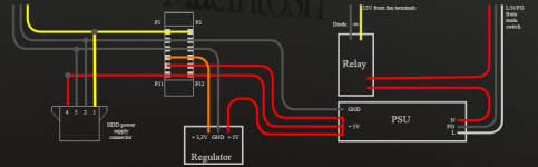

All this sounds to me like a power supply issue, something I read may require modification for this board. powercc.org, the site I followed to modify my CC, says my 5500 series board may require a 3.3V regulator and additional PSU mods I haven't performed. Now I'm not an electrical engineer, so I'll fully profess ignorance on the subject, but I'm a bit confused about how to proceed. I'm tripped up at the bit where the PSU in the diagram connects to the relay, and most everything after that point.
Where do I connect the FG, N, and L lines going out from the new power supply and relay?
Where do I connect the N line from the new power supply into the relay, and where do I attach the second red wire going out from the relay?
Which leads are for what on the relay? Where do I attach the yellow and black wires going to 12V from fan terminals, and what value diode do I use? How do I tell which fan terminal on the analog board is for the yellow wire or the black one?

Actually thinking about it, is it possible that installing just the voltage regulator will stabilize the board’s performance?
Well I soldered in the 3.3v voltage regulator and now the board is stable, but the visual noise remains. I don't think it's power related however as talking to this Takky CC owner with an even more powerful logic board than mine, it turns out his unit has neither a voltage regulator nor a new power supply... so is the problem a quirk of my particular logic board? Who knows.

Thanks for posting your progess - it appears all Takky upgrades are far from the same, with some quirks found along the way depending on varying approaches to the mod.  I've a G3 enabled Takky (not my modification) I'm pretty sure has no 3.3V regulator that surprisingly has never let me down.  I'm going to put a 2.5" MSATA IDE HD in there soon to reduce wattage draw.
I believe the 3.3V line is used primarily for the 5500's PCI slots and not much else.
I could be mistaken, though, as I *really* don't know much of anything about Takky mods (I do have a Mystified CC (pun intended!), but that's pretty simple to do by comparison, involving only a logic board swap with a Performa 520 or 550, so not too relevant here).
