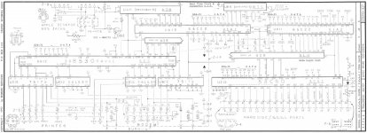

you need to check all the pins on the SCC, and see if they buzz out at their respective counterpoints.
You can check address/data lines from the chip against the ROM socket, as 99% of the databus appears at the ROM SIMM socket.
Follow the schematic and cross off the shit you check with a highlighter.
Once you locate bad traces, its probably only 1 or two, you can follow the schematic because the Data and Address lines at the SCC also appear at the SCSI, the SWIM, and the ASC so you can solder a patch wire to any adjacent IC pin that is on the same net.

My plan is to first check the data bus between 53C80 and SCC, then SCC to ROMSIMM, and then work my way from there, following this schematic page.
Just checked SCC to 53C80 on the data bus (D0-D7), everything checked out okay, now I have to check more pins on the SCC :D
you need to check every single pin. address bus, data bus, the read/write lines, enable line, etc...
If everything rings out, the chip itself could be bad, I have only ever seen 1 go bad. That would be a last ditch effort. Otherwise, i would check the bourns filters to make sure none are shorted to ground.
YES, THAT WAS THE BROKEN TRACE!!!! YES, IT WORKS!
Here is my patch wire:
You can see how I patched from pin 41 (which is RD VERY VERY important) to pin 62 on the UI8 (The large GLU chip)

What's funny is you could visually see how the trace was rotted out (it was actually broken right at the SCC). Had I been more careful in my searching, I probably could have found the bad pin with my naked eye, but methodically checking everything with my multimeter and the schematics is a good thing to do anyway :) Not every broken trace is visible
