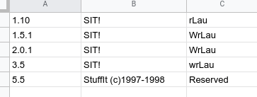

@PowerPup Thanks for those links.  Looks perfect.  I went ahead and did some tests and here's what I came up with.  Looks like it's easy to tell apart pre 1.5.1, 1.5.1, 3.5 and 5.5.

A little luck, but not a lot.  You can reliably tell the difference between "5.5 or later" or "pre 5.5".  I found this to be a useful distinction when browsing archives.  I implemented it into the RetroBridgeBBS interface so that I can tell (when browsing online archives) if the file I want to download is compatible with my machines running system 6 or early system 7 software or not.

This shows the basic idea of predownloading just the file's header, and then determining if it's old or new Stuffit.
sit_patterns = [
[b"^SIT!", "StuffIt pre 5.5"],
[b"^StuffIt", "StuffIt 5.5 or later"],
headers = {"Range": "bytes=0-200", 'User-Agent': USER_AGENT}
header = requests.get(self.url, headers=headers).content
for p in self.sit_patterns:
r = re.compile(p[0])
m = r.match(header)
if m:
print(f"File is archived with: {p[1]}")
Getting a more precise version out of an archive is certainly possible, but it wasn't worth the work to me.
