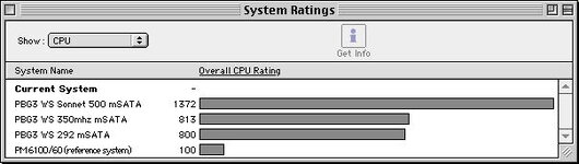

This is PowerBook G3 Wallstreet CPU, one is stock 292mhz and other one is 350mhz appears to be overclocked (overclocked from 292mhz to 350mhz), I thought I'd benchmark it - but it one came up very small amount difference.

Screenshot of the benchmark results.

- your benchmarks being almost the same;
