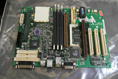

I recently won a ‘sight-unseen’ beige G3 at auction that turned out to have an exploded battery onboard, so I am trying to locate a replacement motherboard to drop into the case. There is only one listed for sale on eBay (in the UK) at this time:
Should I take a risk on it? Could I assume that it just needs a recap, or is it better to keep my cash until a working one comes up for sale?
Beige G3s motherboard are solid. I've yet to run on one that need a recap.
For the price I would give it a try.
BTW the seller said to me in a message: ‘I tested it with known good components, and it doesn't start.’
Still worth the risk?
More information is needed to say for sure. What was the extent of the seller's testing? What were the "known good components" they used? Does "doesn't start" mean that it doesn't power up at all, it doesn't chime, or it doesn't begin loading the OS?
The images on the listing show that the CPU, VRM, VRAM, and the ROM are missing. Did the seller test the board with these installed? I'm also not sure that you can boot a beige G3 board without a personality card installed. I've solved boot-up trouble with my G3 Desktop before by reseating the personality card, so they can definitely have a profound effect on the machine's apparent health.
There is also a jumper on these boards that allows you to switch between the "Desktop" and "Minitower" power supplies. It is by the PCI slots. I can see in the images that it is set to the Minitower "PS/2" position. If the seller tested this board with the PSU from a Desktop model then it definitely won't have worked. Similarly, if they tried to use a regular ATX supply it probably won't have worked either.
As others have said: these logic boards are just about one of the most durable Apple ever made. I have never encountered one that is completely dead. Honestly, I'd take a punt on it if you can afford it. Even if it turns out to be toast I am sure you can pass it along to one of the enthusiasts here (or me 😉).

I put in an offer for the one on sale, so let's see if the seller bites. I think it must have come out of the rusty case he is also selling here https://www.ebay.co.uk/itm/324951070138?hash=item4ba897d5ba:g:nIwAAOSwJ5xhwGiK because I can see that the ports of the board are a bit corroded. Maybe it just needs a good isopropyl alcohol bath to clean up any residual corrosion, as it does look fairly clean.
So I won a different auction in the end for a used logic board (complete with RAM, ROM, VRM, personality card, etc) in excellent condition. Cost about £25. I spent some time grinding off all the rust out of the old case and generally cleaning it up as best as I could. Installed the new board and it all works great. So I have a fully working Beige G3 DT now, and am well chuffed.
