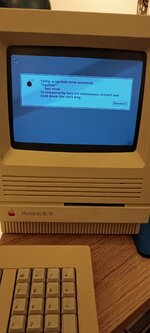

Small update. I swapped out the BMOW and swapped in the original SE/30 rom (and inserted 4x1mb ram instead of the 86 (something) i usually run with. Now the boot is different:
- i get the chime
- mouse works all the time
- FDD tries to read the floppy
- then it gets to the SCSI init-phase and here i get a "bus error" and a restart option (doesn't help to boot with shift-pwr)
I guess its safe to assume that the scsi-chip is gone on this machine. I ordered a new one from Mouser and hopefully that will be the solution.
- i get the chime
