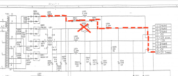

It looks like the 3122V voltage regulator in my PSU is dead. Desoldered it and tested it out of circuit and it does not output any voltage at all.
The +12V Sweep output is only getting the "uncleaned" +12V Disk rail through the two diodes D264 and D254.
Not quite sure why they did things this way... did they expect the 3122V to fail and they wanted things to keep running anyways? :?:
If the extra regulator works the small fluctuations in the 5V and 12V disk rails shouldn't matter anymore as the sweep circuit will get clean 12V from the regulators output.
Any modern replacements for that one available or shall I go hunt eBay for a hopefully non-fake NOS one?

Got a good deal on two SI3122V's on eBay.
Wobbly screen is gone, issue fixed.
Still puzzles me why they built it to still power the 12V-sweep rail even when that regulator dies by using the 12V-disk rail instead.

You can easily test if the SI3122 is still good using a bench power supply once you desoldered it.
Hook up ground to pin 1 and some voltage that is above 12V to pin 3 and you should be able to measure 12-14V on pin 2.
