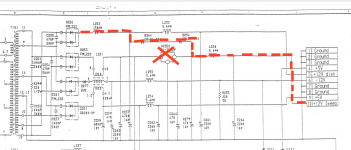

This is my first Sony PSU that is actually giving me problems even after a recap...
Voltages were pretty low to begin with but still in the workable range. I got some pretty nasty screen wobble whenever the disk was accessed or something else taxed the 12V or 5V line.
I started by replacing all caps in the PSU and adjusting the pot in the PSU and it is now outputting a nice 5.07V and 12.18V when idling with a logicboard connected.
However the screen still wobbles (less than before but still there) if there is any change in load on one of the power lines (disk access, Finder interactions, etc...)
Screen still wobbles on disk access even if I use an external SCSI disk and disconnect the internal drive so I have the feeling it is a problem on the 5V line.
Made a short example clip where you can see the screen size changing when I click the scroll bar thingy in a Finder window for example:
https://www.dropbox.com/s/6mdqf9xwgntbyiv/SE30 PSU.mov
You can see that the 12V line drops once I click on it (5V line raises by .1V) and it raises back to 12.2V-ish once I release the mouse again (5V drops again by .1V)
When using a different power supply everything is fine, so I would like to rule out logicboard, analogboard and everything else that's not the PSU :tongue:
Any ideas how to approach any further troubleshooting?
