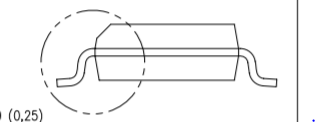

I checked all the vias underneath the battery — they're all good. But I'm not entirely sure the new F258s are installed the right way, since there were no markings on them.

Found that
