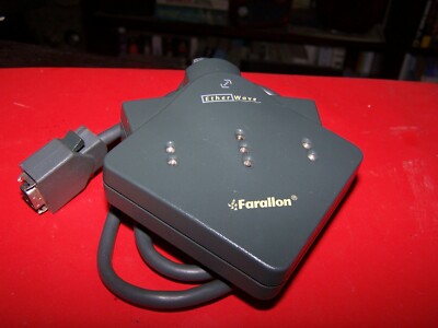

Also being forced to run a AUI - 10BASE-T dongle irritates me. I believe Bolle moldy has breakout boards for those that do have 10BASE-T jacks.
