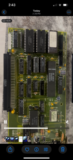

If your etherent card is different, post a high resolution picture of it and I'll see if there's anything obvious.
Great write up. Will definitely take a look and add some high res pictures. Would like to get them working if possible. Thanks!
