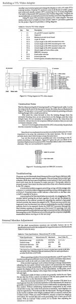

I seem to remember there's a circuit in the first edition of "Build your own macintosh and save a bundle" (what a name!) to adapt the internal video signal to something more TTL-like.  How well it works I don't know, I've never tried it.  Note: in the second edition of the book it isn't there any more, because there was available at that time a pre-made and easier option; but obviously that pre-made and easier option has vanished like a shadow from availability.

I'll have a look and see what I can learn from that book
