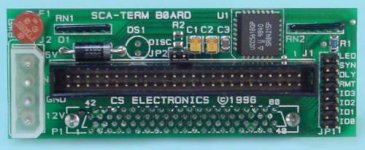

Savvio SCA drives in a 6500?
What else is new? ;D The Savvio works a treat in the 6360/6400, but it's NOT all in the termination.
I swapped in the 6500 board and fired it up, but it hung at the appearance of the cursor. I let it sit like that for a while and then cut power to the Savvio in the external box. It immediately booted the rest of the way no problem at all.
I powered up the external drive and it failed to mount, but I had normal computer function otherwise. SCSI Probe didn't see the Savvio at all this time, but TatteTech was able to tell me about it again. When I started up Drive Setup it poleaxed the system as soon as it began to look for available drives.
All indications are that Apple borked something in the SCSI implementation on the way to 50MHz bus goodness for the series. Go figure? :p
