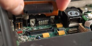

I assume the Kanga has the same green battery of death, first thing remove it, it is taped under the speaker and button bar.
When the battery has leaked onto the mainbaord under it, it is likely damaged, unfortunately.

Yeah I read that and saw that video. I’ll do that. I have a feeling it’s the video ram though. I’m wondering if I can swap the vram from a 3400. I can’t find any pics of the main board or any photos of the vram or where it is on the board to see if it would be possible to lift it and swap it.
You could still change out the chips if the part numbers are still available. Could easily also be a LCD issue, or perhaps if you haven’t checked the battery yet, the LCD cable is right under it. Perhaps the socket has been damaged.

I’ve got some more info on the Kanga.
I get the same distorted display results on an external monitor. I don’t see any visible damage from battery leakage on the logic board.
Is there any hope for repairing the board? It chimes and boots ok it’s just for this display issue.
