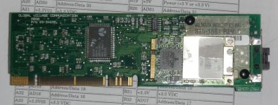

Thankfully, the CS2 NIC shows up in ASP as a PCI Card in Slot $E1 and all necessary signals appear present on the Comm Slot 2 connector for hijacking to the third Riser Slot or in the case of the Interrupt coding bits that are probably built into the logic board, are easily implemented on the third slot of the riser itself.
Adapting PCI to PCIe for using a Mini-Card WiFi NIC looks to be a less impractical endeavor than I'd figured. Mouser sells The TI XIO2001 PCI Bus Translation Bridge (bi-directional) for $6.41.

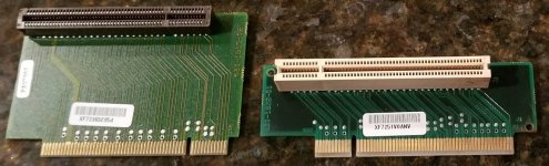

I've got a single slot WrongAngle (Apple config left angle) riser that doesn't work, testing that one for Slot ID incompatibility will be interesting.
Picture's worth a thousand words. ;)
These risers are for use in a 3U or 2U rack case, so they're RA to splay the cards out across Mac risers are WrongAngle for compact vertical expansion over the logic board. I've partially rebuilt my 6400/digitalSTARION 910 as a testbed.
Mouser sells a straight up, no jumpers RA three slot riser analogous to Apple's (ostensibly passive) two slot LA riser.
Sintech Electronics has a a fancier (my KISS compliant card seems better suited to the purpose) three slot riser that's interesting.
