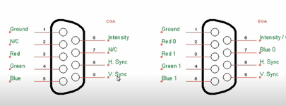

I want to recreate this success with my SE/30 now. I have 2 self-bought, self-assembled RGBtoHDMI units with their Pi Zero and I also used a PC TLL extender board sandwiched between the Zero and the RGBtoHDMI hat. One will stay with the Plus, one will go to the SE/30.
Here's the DA-9 pinout that I've been using. This is the view you get by looking at the female connector on the RGBtoHDMI as well as the view from the interior of the DA-9 male connector as the wires are soldered to the pins.

Does anyone have a list of these settings known to be working on the SE/30?
J12 connector schematic on the SE/30 logic board (leading me to believe it's +H+V polarity; I've tested them all already anyway)
Ok I'm an idiot. wire colors are hard to get right past midnight. I inverted hsync and vsync on the J12 because I thought I could match colors between the SE/30 and my stuff. Still have to tweak some stuff but I'll post my results when I'm done!
