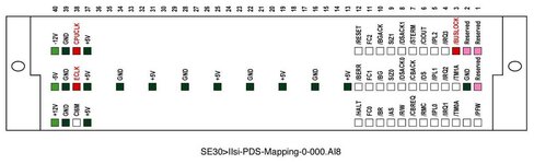

Thinking in terms of system speed and flexibility for combination NuBus/PDS riser design options. The crystal can quartet on the IIsi redux needs to stay in harmony.

| NuBus Adapter/FPU | TwinSlot PDS Adapter | Isi Logic Board |
NuBus Slot $9/FPU -> top PDS Slot -> Bottom PDS = Improved/Rearranged IIci Application Specific Cache Slot -> IIsi Logic Board
NuBus Adapter in Top Slot is connected to Bottom Slot on TwinSlot adapter PCB used in blockish TXT diagram for "clarity" LOL!

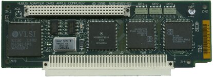

Last time I looked (some 12-20 years ago?) the Controller/Transceiver NuBus Chipset was still available from TI. Wondering if new/old stock parts from TI might be used to build DuoDock's Twin NuBus Slot implementation on an adapter for the IIsi board?
20MHz Docking Connector of Duo Series matches IIsi clock, but that 40MHz crystal can on there and the IIsi NuBus adapter makes me think it might work fine on the IIci 25MHz clock? NuChip 30-33 controller will probably work if the IIci/IIsi hybrid can be chipped that significantly?
IIRC, NuChip30 on IIci schematic would be the designation for 68030 upgrade of the Mac II NuChip ASIC. NuChip 30-33 notation seems max clock related?
NuBus subsystem works just fine on DuoDock with the ROM pulled, so it's independent of the rest of the mulifunction $E expansion card that is the DuoDock.
