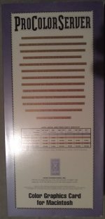

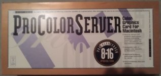

(*) my SE/30 was originally upgraded from an SE, then enhanced with a cpu socketed 33MHz Daystar PowerCache 030, then further enhanced with a Lapis ProColorServer 8.16 video card - even found the original packaging for both the Daystar and Lapis boards!

I'll see if I can get some scans of the Lapis manual...
