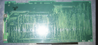

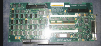

Before I pulled the gargantuan power supply, I was fearing that the pooled corrosion was from a blown battery. I was VERY surprised to find that the previous owner had pulled the battery (luckily), but that the corrosion was coming from the PDS(?). And, on this board, there are ZERO electrolytic caps! Clearly Apple designed this board to last!
In all my time working on computers, I have NEVER come across a CPU that had the pins separate from the die casing!
The CPU pins I extracted from the slot.
After an ultrasonic cleaning with a couple tide pods, the board came out looking near brand-new! I use my ultrasonic cleaner after I remove caps, but before I solder new tantalums back to the board. It works great to remove corrosion from the board.
