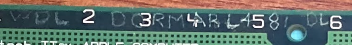

OK folks, after fifteen days this Macintosh IIcx restoration has finally reached the finish line. It began with a non-functional bucket of parts, coated in capacitor juice and exploded battery goo, and ended with a completely restored and fully working Mac. This is now the best-looking machine in my lineup, with a clean case that's virtually free of any yellowing, and a sexy blue power LED.

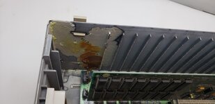

In case you've forgotten where this all started, the IIcx was in sorry shape with capacitor damage and battery damage:
Repairs and upgrades made:
  • Brushed clean the motherboard with alcohol to remove battery/cap residue
  • Hosed down the case and washed with soap
  • Removed the old battery holder, which crumbled into plastic cheese in my hands
  • Recapped the motherboard with tantalums
  • Repaired three broken traces in the soft-power circuit
  • Replaced 74HC132 at UM2 and reflowed solder joints on the other chips in the soft-power circuit
  • Repaired a broken trace to the RAM mux that prevented 4MB SIMMs from working
  • Restored a damaged RAM SIMM by reflowing solder joints on the RAM chip
  • Installed a new battery holder
  • Swapped the power LED for a blue LED
  • Bathed the motherboard in hot soapy water followed by a full alcohol submersion
  • Replaced the gear in the floppy drive eject motor
  • Lubed the gummed-up floppy mechanism
  • Brushed and scrubbed the floppy drive controller PCB to remove conductive goo causing problems
  • Replaced the PSU with an ATX conversion inside the original PSU enclosure
  • Installed a MeowToast CR2032 battery
  • Installed a Macintosh High Resolution video card
  • Installed a Zulu SCSI hard disk
  • Replaced the missing programmer/reset buttons
  • Played one game of Tetris Max
This probably makes it sound like I knew what I was doing and had a plan for everything, but in truth I was just banging into problem after problem. For a long time the motherboard wouldn't do anything, then finally it would play chimes of death, then later it booted but exhibited a variety problems, which had to be hunted down and fixed one-by-one.
Many thanks to everybody who offered troubleshooting help, especially @Phipli who always offered productive advice for everything that went wrong. I definitely wouldn't have finished this Mac restoration without all the assistance I received here from 68kMLA.
So there it is, a Macintosh IIcx with 16 MHz 68030 and 20 MB RAM, working as well as the day it was built. Here are some photos of the finished product:
