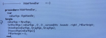

Thanks Crutch, I just tried this but it’s telling me that mBarRgn = NewRgn; does not make sense as a statement. Here is what I have if I did something wrong Please let me know. Thanks again for your help, I don’t have anyone close to ask about this stuff.

Sorry. I obviously haven’t used Pascal in decades … my two assignments above should use := not =
Corrected below but definitely I would advise getting to a good base level of Pascal syntax and Toolbox comfort before really trying to build off of this. The book you are using is a good place to start!

This is what I’ve got to so far, I tried the updated code with the help from crutch but it said that mBarHeight and gray region was not declared. I tried to correct this by doing this in the picture below but now it says I’m out of memory. Does this look right?

MBarHeight and GrayRgn are so-called “low memory globals”. Check the THINK Pascal docs on how to access low-memory globals. I am pretty certain there is a way.
If not, to set (for example) MBarHeight you just need to write 0 to the Integer located at $BAA. (Inside Macintosh volume III gives the addresses of all the low-memory globals.)
In Pascal you could do this with something like …… (again syntax errors likely, I don’t use Pascal)
type
IntPtr = ^Integer;
var
mBarHeightPtr:IntPtr;
begin
mBarHeightPtr := IntPtr($BAA);
mBarHeight^ := 0;
end
And likewise with GrayRgn
