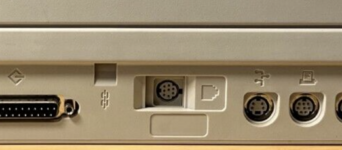

Well, the portable arrived and I have some good news and some bad news. The portable initially did not power on, just like the seller said, even with a refurbished battery that I prepared. It showed different sad mac codes. The motherboard was clean, no signs of corrosion or evidence of any other repairs.
So the good news: After I washed the motherboard inside the dishwasher it worked right away! It booted every time, backlight works etc.
Bad news:
a) The sound did not work at all. No chime etc. When playing an audio through the sound control panel, the mac would freeze for a few seconds. You might say it needs recapping. I recapped it just yesterday - high quality parts from mouser. After recapping it sometimes tries to chime but then throws a sad mac code (rom error), other times it won't chime and continue booting. Any thoughts?
b) Unfortunately it has the tunneled vision syndrome. It starts after about an hour. It is really bad, The black and white actually get inverted in the corners.
c) one dead pixel
d) the ram expansion is 4mb, the seller had it listed for 8
I would really appreciate your input on the sound problem.
edit: By the way, there is a method to power on the motherboard without the keyboard, by shorting two pins on the IO connector. Do you know which ones they are?
