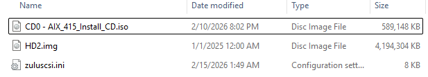

I'm trying to figure out how to reinstall my new (problematic-a topic for another thread) ANS500....
It boots fine off the drive that came with it, but it definitely needs a reload.
I've setup the structure of my SD card as:
Set the keyswitch for service...
I've tried IDs 1, and 2 (2 was the ID of the old drive) for the drive with the same result.
Term DIP switch on and off, same result.
Any suggestions/idea what this means?
I've never booted aix before.
