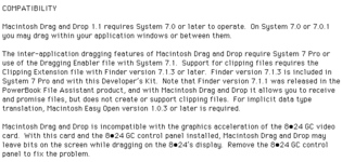

This is in the ReadMe for Macintosh Drag and Drop v1.1:
This is probably the source of visual artifacts from 7.1.1 (P) forward. Any use trying to strip it from later versions?
@jeremywork Very interesting find. I'm going to have to break out my card and give it another go next week. Make sure I don't have Drag & Drop installed.
Their solution is to remove the 8•24 GC Control Panel; but don't you need the Control Panel for acceleration?
Yep, same solution was offered when the user accidentally bought a Quadra.
