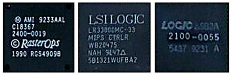

There is absolutely no info about this card anywhere on the net. Looks like it is a JPEG Compress/Decompress card and probably speeds Photoshop plug-ins like Thunder Storm Photoshop Booster. There is a processor LR33000MC - 33 MHz chip on. Is this some kinda DSP processor?
Would this card speed a QuickTime video compression when grabbing a video? Any info would be great.
I think this is an embedded MIPS chip.  So a reasonably conventional processor rather than a DSP, presumably being used as a copro here.  Which would make sense for still image work.  I wonder if one could upload arbitrary code to it :-) .

RasterOps is following a similar strategy, with a 40-megahertz LSI 3000 RISC processor on a daughtercard to match its video cards. Although the chip is completely programmable, RasterOps envisions that it will first be used for JPEG (Joint PhotographicExperts Group) compression and decompression. It is fast enough to capture QuickTime movies with near-real-time frame rates -- 15 frames per second and higher at full-screen resolution.
Well, MIPS is a general-purpose RISC instruction set, similar to the way ARM works.  There are then multiple different kinds of processor for different applications made by different companies, but which implement the same instruction set.
That particular one doesn't seem to have an FPU on-chip (the datasheet is here: https://www.alldatasheet.com/view.jsp?Searchword=LR33000MC) but does have a DRAM controller, and seems to be designed to get integers into and out of memory as fast as possible (note the emphasis in the summary at the top of the datasheet).  What's more, it doesn't support any offboard coprocessors either.  So I would think it's a more generic embedded CPU than one designed specifically for DSP.
