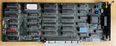

Just optained a nice Q650 with a Toby and Radius TPD II Card. I have not found any specific info about the card. I guess, it is a 1-bit card and runs at 1152x870 as this is the standard apple two page resolution. however, I can‘t get it to run without a greenish screen. I am using the 2 row 8 dip adapter and tried 1152x870 with setting for sync on green, comp. sync and separated sync. Still only showing nicely green…..
Any ideas?

You need to tie red/blue/green together at the monitor cable end to output Black and White from the card if you have the same problems I had hooking up the SE version of the Radisu TPD
Date on the card suggests single bit, but that DA-15 connector shows at least the tiniest bit of hope for GS. Older units had coaxial hookup:

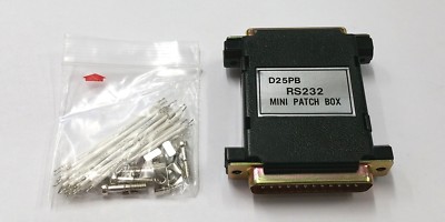

Thanks for the valuable input. Thinking of this one from Amazon - guess it will work. Also checking for the pin outs for DB9 equipped cards like the Miro Prisma nubus graphics adapter. But sadly, DB9 was not standardized unlike DB15 Mac or VGA.

Very nice! You can do your DE15 VGA conversion and Portrait Adaptation in one shot. What are you using on the 13w3 connector of the Portrait? Cut one of these in a convenient place and you can work out your adaptation to VGA on a prototyping PCB. When you've got it working cut out the PCB and splice the wires/shrink wrap for a nice clean cable.
Not using 13w3 at all as I only have the TPD 2 card, not the display. I am trying to get it run on a Dell 22“ TFT that works quite well with all those old video signals from Toby, Futura SX etc….. I only have a 15“ Nokia Multisync Trinitron CRT, a bunch of Apple 13“/14“ and an Apple 16“ fixed frequency ones.
