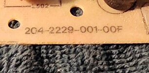

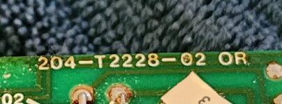

Also, here's the list of the capacitors I bought:
