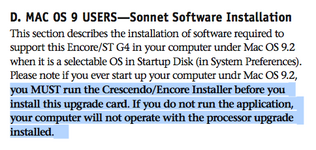

I just put a Sonnet 1.6Ghz into a quicksilver. It doesn't boot. It does with the apple CPU card though.
It was suggested to me that the firmware needs updating, however, the only Apple firmware updates I can find are for machines older than the Quicksilver. Sonnet's website provides a firmware updater for OS X, but I don't have OS X. I don't have a computer with a disc burner to make a copy with, either.
Someone gave me a copy of some sonnet software "Crescendo_Enc_Ins_2.3.1.sit", which is an installer that claims to have a firmware updater in it. It tells me to boot the system while holding down the programmers switch and it'll do the firmware.
Only it doesn't. If I hold the programmers switch in when I boot, all it does is flash the power LED for a while and dump me in openfirmware. And then if I reboot and go back to mac OS, sonnet's software bitches at me for not having the correct firmware installed.
How do I get myself out of this situation?
