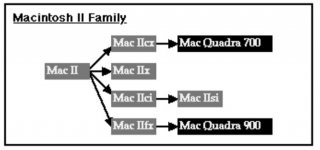

When the 900 was being developed, its internal codename was IIex. My guess is that it was a "fast, enhanced, extended Mac II" if you follow the naming logic. Given its size and position in the lineup, it's very reasonable to think of the IIfx as the starting point for the design.
Interestingly, the 700 was code-named IIce. Note the "c" and similarity to the IIcx/IIci. A "compact, enhanced Mac II" perhaps?
