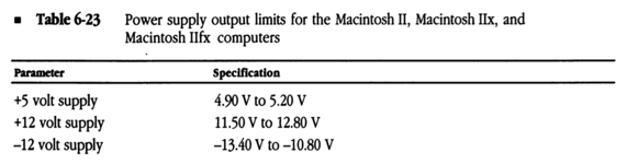

Are you really sure a resistor is required? 12.5V lies within Apple's PSU specification (at least for the Mac II series). You could save a yourself a lot of trouble and energy ;) The voltage will certainly drop when you put two 5.25" hard drives in 😅
Hi @robin-fo !
It will work without it but I noticed that the Bicker PSU was having to work harder (and therefore hotter) in order to keep things going. So for stability/longevity reasons, it's better to have a load resistor when using newer fans...
