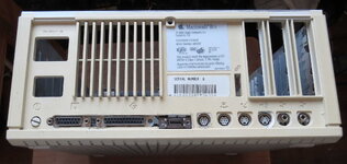

I installed the Q650 motherboard into the cx case because of the three NuBus slots, and the Q700 motherboard is back in its original case.
... I still need to do a bit of rasp and hone on the back panel, and then paint it.

I've just received a large collection of IIcx/IIcis and machines with compatible logic boards. Both the Quadra 650 and Quadra 800 logic boards will fit in the Quadra 700 case, unmodified, and are directly compatible with the PSU. This is just a drop-in replacement. The Power Macintosh 7100 will also fit, but you will need to cut holes in the back plate to fit the different ports, so I suggest using a bombed IIcx or IIci case instead of wrecking a Q700 case.
