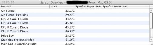

I then reassembed the lot, booted, and what do you know? The thing works perfectly, at the moment at any rate. I've attached a screenshot of the CPU temperatures over a five or six hour period today under varied levels of activity.
Iam not sure I will leave it this way, but at the moment, the machine appears to be working as well as it ever did. Temperatures are about normal for a G5 Quad (Processor is set on Automatic). While posting, I took a shot of the current temps in numbers for posterity.
Neat, wot?
Unfortunately, it fails thermal calibration in ASD2.6.3, which reports that the readings are out of specification. So I have to operate under my previous settings.
