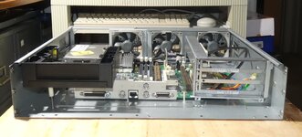

I've got a case with 3 PWM fans and an incompatible (Beige G3) logic board. I'd like two fans to run off a power level a step below the third in any combination of the three voltages available on an ITX PSU.

I imagine I could build a hovercraft with a IIsi using these things. They were set up blow straight into this 2U server case thru a full frontal dust filter. I have them blowing out the backside, still sucking air in thru a different full frontal dust filter.;)
Ductwork will direct air straight thru the heatsink at 5v driven RPM, the other two are 3.3v RPM gravy I think.

I have to use an ATX 24pin to 20pin adapter cable for the BG3 and I've got some short 24M-24F cables. The unused pins are 3.3v, 5v,12v and GND. To figure this out, I'm just gonna lop those wire off the 24 pin source ahead or the 24pin to 20pin adapter cable and fiddle with it. 🤪

Even with a "hot" accelerator, ducting air directly thru the heatsink, that fan running at half speed ought to suffice? Noise should be less than my MDD, no?

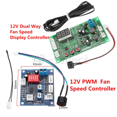

Or just buy a premade temperature to PWM circuit.
(The ones you've bought might work but are actually designed for driving normal two wire DC fans or motors with PWM, rather than specifically PWM fans).
Perhaps this? No experience of it myself, it is the type of thing I'd make my own so that I could tune it exactly how I wanted.
(The blue board)

Interesting about the fan controller, thanks! I guess we'll see how that works out, it explains how they hook up to 12v/GND inputs, was wondering about that.
Agreed. It's better to use a fan's built-in PWM switching since you usually get better speed control and less motor whine.

Thanks! So I should be able to treat them like two pin fans using the non-PWM controllers above?
