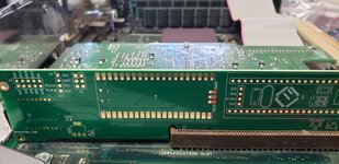

These "universal" serial-only CommSlot PCBs just showed up today, and so far, we've only confirmed that they physically fit in both CommSlot I and CommSlot II sockets, which is a relief. It has footprints for an ESP8266-based Adafruit ESP-12F ($6.95), Raspberry Pi Pico or Pico W stamp, (RP2040-based MCU), or the ubiquitous "Blue Pill" boards (Choose one). This Universal CommSlot serial boards are really simple. All it does is provide voltage translation (to 3.3V, from the 5V CommSlot interface) for the serial pins, a buffer, and a 3.3 volt regulator.
ONLY the serial signals are wired to the edge connector in this revision (2022a). J3 is an SPI pin header which brings out SPI signals from the three different modules to a 3.3V pin header. J4 is the same, but for I²C.
Here's the six-component Bill of Materials, which can cost as low as $5-6 per board. The cost of the ESP8266/Pi Pico/Blue Pill boards is in addition to the base BOM cost. The PCBs cost $2.45 each (shipped), because they're gold ENIG plated, and we didn't order very many. When these are fully tested, we'll eventually be releasing the board design files under an open source license, likely the CERN OHL-S V2 (strongly reciprocal), which is GPL-like, and will order a few hundred PCBs for resale. Until then, if you want one to tinker with, see below.

Needless to say, this isn't fully-baked yet, but anybody who wants a PCB and the core BOM components, please let us know. Due to the cost of international shipping, it doesn't make sense to ship these abroad from the US. If anybody here would like to have a handful of blank PCBs sent to their non-American shipping address, please contact us via PM. We're willing to sell these PCBs at near-cost, as this is a hobby board at this point. The initial goal is to be able to use an ESP8266 to connect a Mac to "dial up" to modern Wi-Fi networks, using OpenTransport/PPP, and the ESP8266 or Raspberry Pi Pico W as a bridge to the outside world, albeit at serial speeds.
