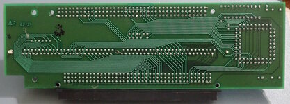

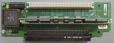

I was pleasantly surprised by an unusual PDS adapter with a cache SIMM. PSI 030 BUS ADAPTOR REV B P/N E-0K-0-51C 1990/1991. The adapter has the FPU installed. (There was also a video card, but that isn't the focus of this post.)

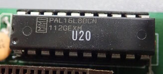

There's a PAL on the adapter. I assume this is for the FPU.
I don't like the look of that ceramic capacitor.
Nice bend on electrolytic C1! When I recapped C2, I made the mistake of installing a taller capacitor. It barely fits -- rubbing against the power connector for the hard drive. C2 really needs to be small like the original designer installed.

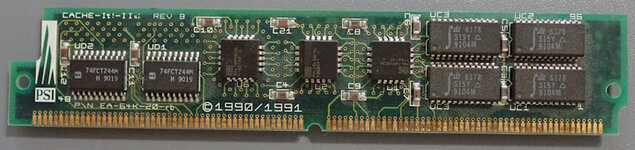

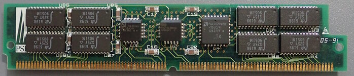

The cache module is labeled PSI CACHE-It!-IIsi REV B. P/N EA-64K-20-rb 1990/1991. Based on the 64K part number (and tests presented later), this is a 64KB cache.
A cache simm is a pretty cool concept for 1990. It would be cool to swap in a larger cache, but I assume this is a proprietary pinout.

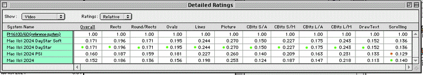

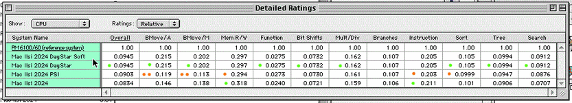

I ran Norton System Info speed tests on System 7.1 on the IIsi. I compared the DayStar FastCache (with the control panel software and without) vs the PSI vs the stock IIsi. The PSI cache did not compare favorably.
Notice that BlockMove is particularly bad (below stock) on the PSI cache, but not on the DayStar cache. I wonder why?
Video performance is generally better with a CPU cache. Still DayStar constantly beats PSI.
Just to be sure Norton isn't wrong, I ran my cache tester program. Results were consistent with Norton.
In conclusion, the IIsi receives a moderate performance boost from a CPU cache. DayStar is better than PSI.
