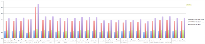

Since Speedometer compares QuickDraw data to the Quadra 605 and I've generally used the IIci video numbers from Apple Personal Diagnostics, I've doubled the IIci percentages so the graphs are easier to discern.

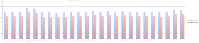

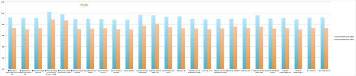

ONE BIT QUICKDRAW

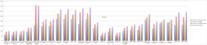

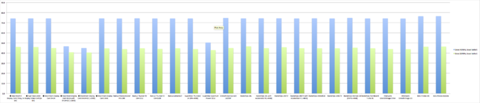

TWO BIT QUICKDRAW

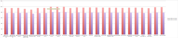

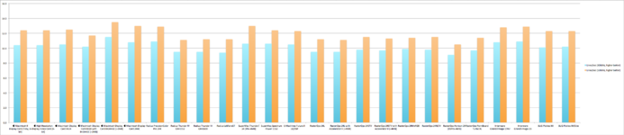

FOUR BIT QUICKDRAW

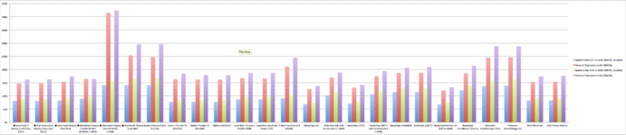

EIGHT BIT QUICKDRAW

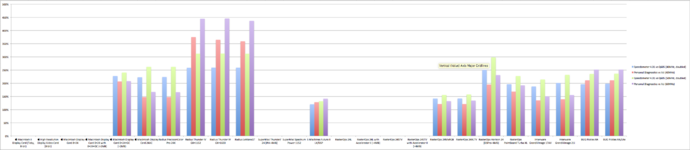

SIXTEEN BIT QUICKDRAW

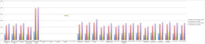

TWENTY-FOUR BIT QUICKDRAW

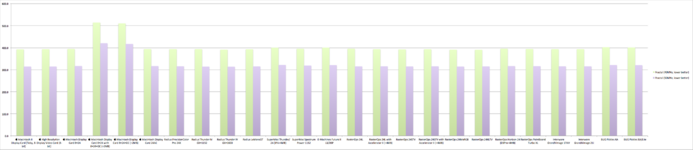

DAYSTARS (seconds)

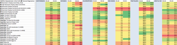

QUICKDRAW (data)

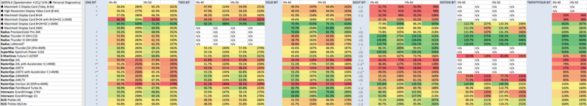

POWERDEMO (data)

I'm happy to have made a dent! A few days in I began to realize why this hasn't been done very comprehensively. The more time I spent, the more questions I seemed to have, though with precise control and enough repetition I began to understand the layout of the field. I think if we built a more disciplined benchmark there would be even more to learn.
Both of the QuickDraw tests concatenate many different aspects into a single duration test so it's not easy to visualize that, for instance, the Horizon 24 is essentially as fast as the Thunder IV cards but simply doesn't accelerate the drawing of colored text. As a result, the Apple Personal Diagnostics test practically flops compared to the Speedometer test. Having sat in front of the screen watching the tests draw, I can contemplate their similarities, but anyone looking only at the data would be unlikely to draw the connection.
This said, I'm not sure what would be most informative from here: expand the test regiment, test this same set of cards in more Macs, or start compiling resolution/color depth and feature attributes?
