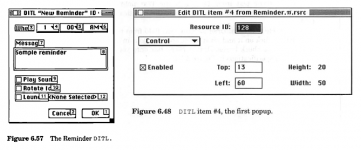

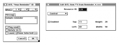

In the meantime, does anyone here have any ideas about why the texts don't fit in the popups like they do in the book?
Book:
My version:
OS 9:
