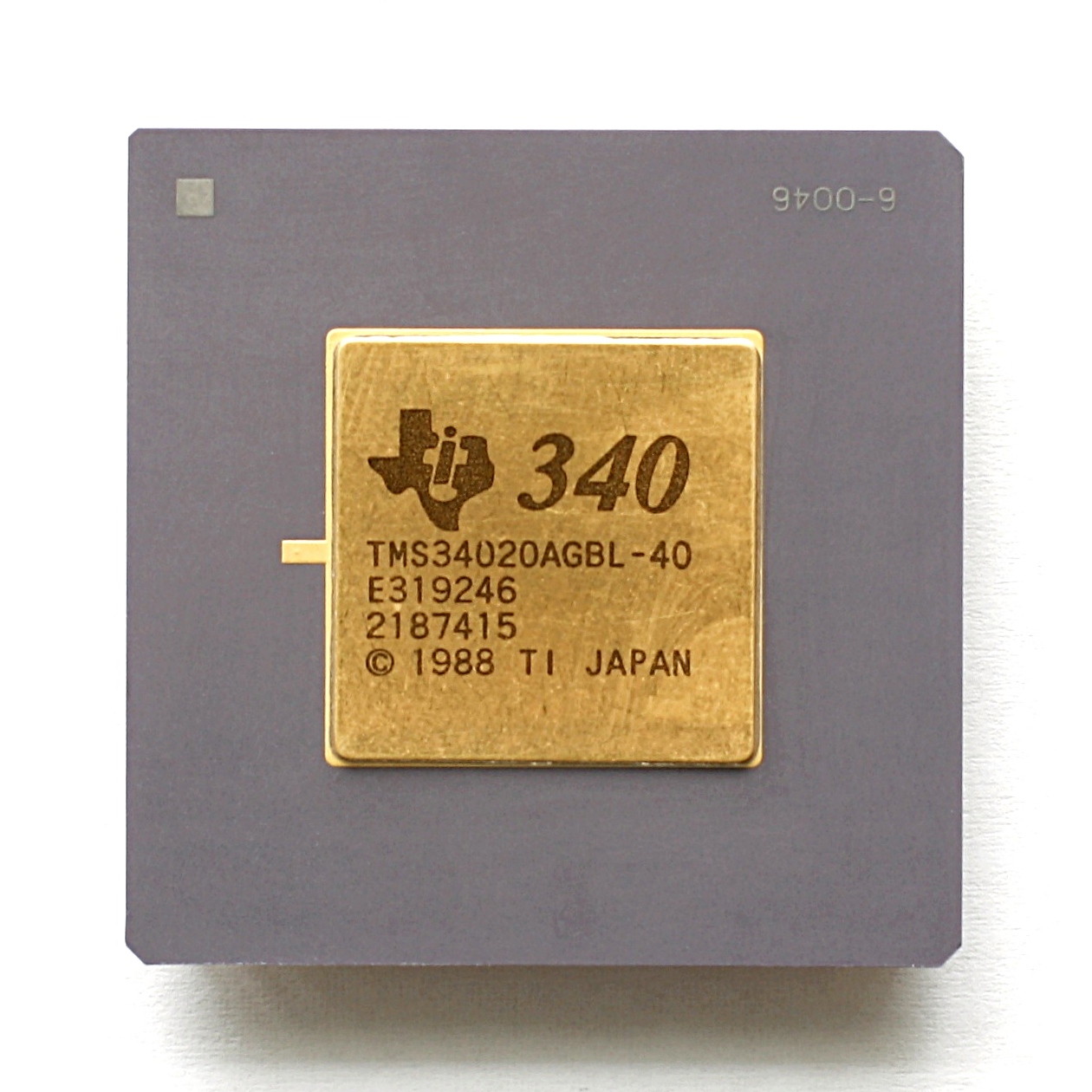

I've spent a while playing with the Precision Colors. While I have to avoid settings the overclock the RAMDAC or use more VRAM than fitted on boards like the 24XP and XK.... I may have ended up fitting a larger ROM and reappropriating the jumper header to use as bank selection between the correct V2.0 ROM and the 24AC ROM... This gives me the option of using the 24AC's PPC acceleration on other boards!
Thank you for the PPC acceleration :)
I have one question (possibly others). The jumper I used to switch the bank. As manufactured, one position pulled the most significant address bit high (I think) if you fit a double sized ROM, or I think a write enable pin if you had a standard sized ROM. The other position connects the same pin to one of the custom ICs - do you know what functionality this was for? Flashing the ROM? Bank swapping? Big ROMs?
