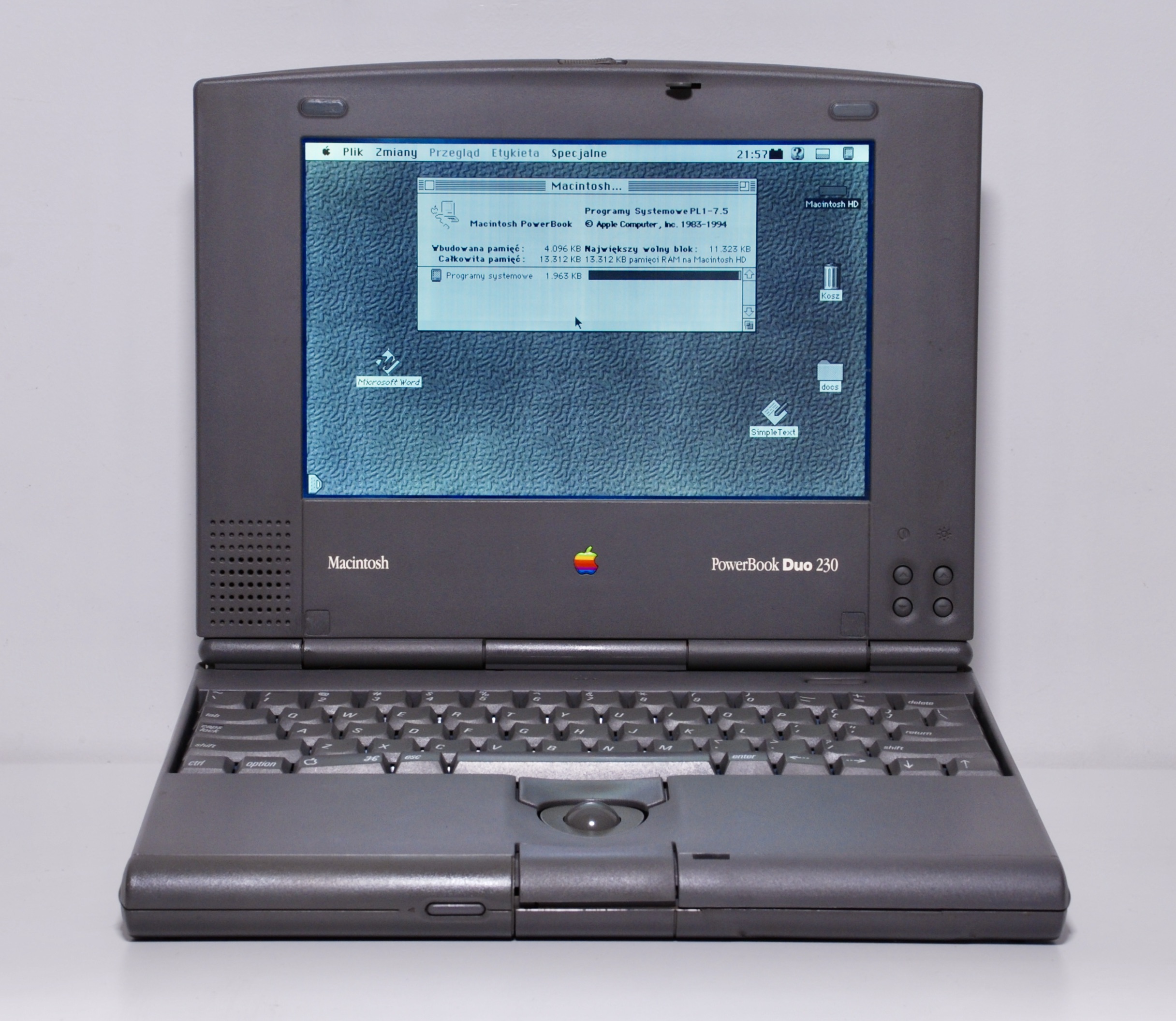

here is a good reference site with photos from a Duo 230:
