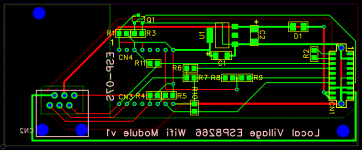

Here's a pic of the current PCB layout, which I still need to extensively bench test before sending to fab. Amazon delivered a pair of ESP-07S modules today, so that can now begin in earnest!
All components I've spec'd are modern and readily available, even the 20-pin AMP connector (P/N 104652-2), which had me worried might be NLA. Whew! Note that I've routed the pins necessary to update the module via an FTDI interface to a 6-pin RJ11 in the same position as the original, so programming will be a simple as crimping an adapter and plugging it in :)
I still have a TON of questions to answer though... Notably:
  • Do I need to worry about flow control? I've routed traces for the RTS / CTS pins, but not sure they're necessary or how that will need to be implemented on the ESP2866 side.
  • The ESP2866 and its logic-level runs at 3.3vdc vs. the Global Village modem's 5v. I've added a linear regulator circuit (top center) for the supply and voltage divided the 5V inputs from the PowerBook, but I'm not sure if the 3.3v outputs from the ESP2866 (in particular TXD) will meet the minimum Vih requirement to be recognized as "high" on the PowerBook side. If not, I'll need either a chip-based, gate-type conversion (fast but more complicated) or diode offset (too slow?) level shifter.
  • DCD - Not sure what to do with the data carrier detect pin, or how the Power Manager / modem drivers use it in all cases. Thought about just tying it to GND, but that could have unexpected consequences I imagine. Instead, I sent it to an unused I/O pin on the ESP-07S and currently plan to alter the SLIP code to swing it high / low in response to active wifi connectivity?
  • SPI - PB 16Xs & 18Xs, while modem hardware compatible with older 1XX generations, support "express" modems and allow for some sort of then-new-fangled higher speed signalling using more data paths called SPI. By pulling pin-16 high, various pins previously used for other functions are remapped. I drew R8 with the intention that by jumpering it high or low with a 0Ω "resistor", I could try fiddling with SPI, but given the limited info available and uphill battle I'd face to get the ESP2866 to speak that protocol, I'll almost certainly delete that bit and live with RS-232 port performance. Speaking of which...
  • How fast will that internal port really go? Without knowing anything about how that RS-232 is implemented, can I assume the theoretical limit has the same hardware clock 115200 / 56Kbps ceiling most legacy RS-232s do? For what I have in mind (ssh, IRC, HTTP graphics-lite browsing, etc.), 56K would be plenty fast. Guess I'll find out, but knowing the "Express" modems (those same modems that required SPI ostensibly due to internal RS-232 port speed limitations) were themselves only 14.4 / 28.8, I'm worried...
  • A ton of other stuff I haven't yet thought of...
Probably going to take a few months to develop at the speed of 15-30min here and there amidst myriad other time commitments, but at least the ball is rolling :)
The components I've ordered are still arriving, but in the meantime I spent some time getting the board layout closer to actual. Upon further review of the "Modem card electrical interface" section of the Deverlopers Note, it became obvious that I'd need to convert logic levels down and up (Vih is 3.5v), so I added some BSS138-driven logic converters on the Tx and CTS pins, with simple voltage dividers for Rx and RTS. Not sure I'll implement flow control, but the UART supports it, so may as well leave the door open.
The biggest caveat I'm currently contemplating is that the logic board's internal 20-pin modem connector is the only RS-232 port and the only port operating at CMOS voltage levels. Testing via the external RS-422 ports is possible with some conversion, but for accurate testing I may end up soldering a ribbon cable to a 5-104652-2 (CN1) and routing it out the RJ11 port. I might just click "I'm Feeling Lucky" and send the CAM files to OSH Park as-is and have a them send me the 3 board MOQ to :)

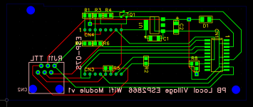

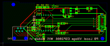

Here's the final board layout. I ordered 3 from OSH Park today!
Huzzah, my boards arrived! I assembled two without issue aside from the diameter of the through-holes for the ESP8266 headers being a bit tight.
More importantly, upon install in my PB180 test mule, everything lines up perfectly!
