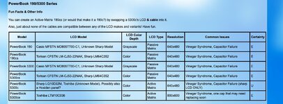

I definitely only lost a couple, but I have a parts 5300c on its way that I'm hoping I can bring the screen around on with a recap. Hopefully its battery connector is in better shape and I can fix up this 190. For something that should have fragile 30 year old plastics, this 190 is in remarkably good condition, quite a bargain for $65.

Mine wasn't quite that bad, and the connector might be at least partially salvageable. It boots, but the screen caps are shot (go figure). I can't seem to find 10v 33uf SMD caps, hopefully a 16v 33uf radial mount will work in that spot. I'll probably finish recapping the screen on that, then transfer it to the 190 (assuming the caps are the only problem it has) and make a 190c out of it. The 5300 got a lot more blue goo than the 190 had, so I don't know if it's worth trying to save the logic board, but the keyboard and trackpad certainly feel fine, and it might have come with a larger RAM module (not the mythical 32mb, but if it's interchangeable it might make 16mb at least).
The battery connector on the 5300 does appear to at least have more intact pins than the 190's, though. Only 2 pins are broken on the 190, so I might be able to make 1 intact connector between the two laptops. Having a battery in this setup is important to me.
Can't show pictures of the 5300C, because it's in pieces, but here's the 190C Apple never made:

CF > IDE adapter, BlueSCSI connected via HDI30 adapter. Currently OS 7.5.5, but I'm running into some trouble with getting the BlueSCSI networking working properly, so I may go ahead and load an OS 8.1 image onto the BlueSCSI and try that instead.

nice display..I think the 5300c's active matrix screens fits very well to the 190..
