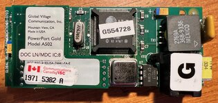

Yeah, I used ZTerm to play around with it, it responded to all the normal commands. I connected two PowerBook 180s together, and established a link to my PowerPort Gold.
