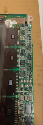

don't forget to recap the display!
and make sure to clean off this area too. the fluid leaks through the vias...
