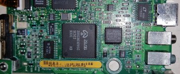

I purchased a 145b for $50 today, the issues can be seen in photo. No chime, lines on screen and corrosion. The powerbook still has original battery but I removed it. What should I do to fix it?
Here is more, there is no corrosion under the board or under the daughterboard, only in the spots in the photos.
It did chime before and display a blank screen with a cursor, forgot to say. Ill wash it on Wednesday and report the results. My university has a classroom with facilities to bake boards, solder very tiny components and so on, I will take it there on Friday if Wednesday's clean isn't a success.

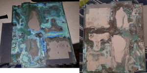

I got it working kind of, partially cleaned the board. I can move the mouse around but the screen flickers and has bad ghosting. Chimes too. HDD and floppy not doing anything.
Photo is what it looks like currently.
Ghosting may be just usual behaviour for that kind of screen.
Flickering is probably due to bad capacitors on the screen LCD and inverter board.
Hard drive is probably stuck.
the board isnt clean enough. You really need to ultrasonically clean that board, thats really the only way short from removing all the components to get that green corrosion out. Its conductive and causing all your problems.
