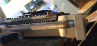

I finally managed to snag a 604e zif from one of those IBM servers.  The chips were usually just included with their motherboards (which I didn't need or want), but one finally came out as a lone chip.  It fits in well, dropped straight it.  Although, as the picture shows one corned is slightly raised, not by much and I'm sure the pins are still making contact.
I haven't actually ran the Powerbase with it yet as I'm having trouble finding a heatsink/clip to fit.  I might end up fabricating up something crude but functional.
