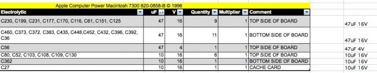

Considering there is no reference for caps online, I have typed the values into my spreadsheet and made a screenshot so the formatting is retained.
Jeremy
