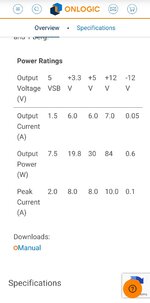

I found this (here):
And this :
Looks like the -12 is rated at 1/10th, but the 5V is up to spec. You'd need a huge DC psu.
Off those numbers, assuming the pico is 90% efficient, you'd need about 85W DC supply, aka 7A 12V (to match ratings).
