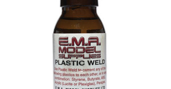

Yes, if you have all the pieces then it can be repaired.
You need (I strongly recommend this specifically, not something similar or equivalent):
and something like this, or a very fine brush works ok too:
Also useful is some raw abs (abs printer filament works) and acetone to mix up some abs liquid/gel to reinforce joins on the inside.
However, if you value your time and sanity, the replacement facia from Greece might be the better option!

I found the broken fragments in the delivery box, and have loosely fitted them in place, just need glue and filler to make the rest of the Bezel.
There are some other smal fragments of plastic not shown, just trying to determine where they go.
I have order some EMA Plastic Weld Cement, and the filler can come from ABS filament, I already have from 3D Printing.
