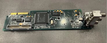

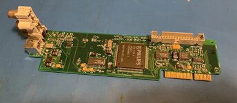

Does anyone know the difference between a 820-0737-1 and a 820-0567-A? I realise the last character in the part is the revision, so that may change on your card.
I want to make sure I have the right one for my purposes.
Both look effectively identical, even the same 34 pin connector (there was a later card with more pins).
820-0737-1 :
820-0567-A :
You should be able to search earlier threads here or in the Snitz Archive with info on both connectors. IIRC the 60 pin connector is an expanded version of the interface to the MPEG Media PDS Card. I've got that one, but no card requiring the 60pin interface.
