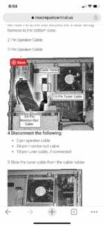

Hi everyone,
I got an absolutely filthy 6220CD. I stripped it down, cleaned it up, and am in reassembly mode. I plugged everything back in to what I thought was the correct slots, but I couldn't get the machine to spin up. Then I tried taking the 34 pin monitor cable and plugging it in a 34 pin port on the motherboard (see pic). The machine spins up when I do this, but there's no way to get video out to the monitor. What am I missing here?
